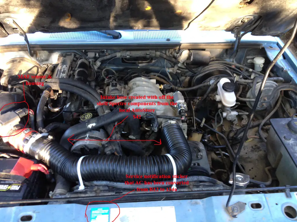

Here we get a good view of the solution for the old, busted, leaking air intake tube I came up with using off the shelf parts from the auto store. I have a separate thread that lists all the parts, part numbers and prices (at the time).
For grins, I pointed out the location of the MAF unit on the left. I got the sensor and housing (reconditioned) from the local auto store for half the cost of a new sensor by itself! There was nothing wrong with the existing housing, but hey, I went ahead and replaced them both since it was a packaged deal.
And I had to point out the R12 to 134a conversion..
I did this with a $50 kit that simply included 3 cans 16oz of 134a(10oz), oil (4oz) and stop leak (2oz), a CD with video (available on youtube), a reusable Charge hose and 134a connector adapters that screw over the existing R12 connections.
The video basically said to identify the high/low pressure lines, purge the system (properly), screw on the adapters and charge..
What they left out was the wisdom in replacing the dryer/accumulator (which I did) and all of the old O-rings. Apparently, the old black rubber rings don't get along so well with the new 134a. Whereas the new green rubber ones work for both 134a and R12. I got an O-ring/Spring retainer kit from Orielly's for $15 plus the little multi colored tool pack for removing spring lock connections and replaced them on all hoses, fittings and compressor.
