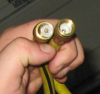

OK, so I'm gonna sound like a total n00b on this one, but I bought a set of manifold gauges at Advance a little more than a week ago since I noticed my A/C system's performance left something to be desired. Turned out I needed refrigerant. So I decide to add the refrigerant and attach the tap valve and can to the end of the yellow hose. I opened the tap valve and opened the blue service valve. I come to the realization that the system is not taking any refrigerant in. The low side pressure was 35 at the time.
So I'm pretty much baffled at this problem, when I remember the yellow hose has a type of valve inside of it that only opens the hose when something's connected (ie, doesn't allow refrigerant to escape and air to get in the manifold). The problem is it appears to be holding back too much pressure.
I ended up using a little bit of redneck ingenuity to add refrigerant to the system. I disconnected the blue low pressure hose from the service port and then from the gauge set, attached the tap valve to the gauge end, purged the air from the hose, attached it to the low side port, and then began charging. Of course, the problem now was I could only monitor the high side. To check the low side pressure I had to reverse the above procedure. I was already tired of that the first time I did it...
Also these hoses don't have valves on the ends of them. I thought EPA regulations required that, but on the box it said that the auto-close feature of the quick-disconnect ports were enough to satisfy EPA requiements.
Anyway, what do you think the issue is? I can't seem to figure out what I'm doing wrong.
