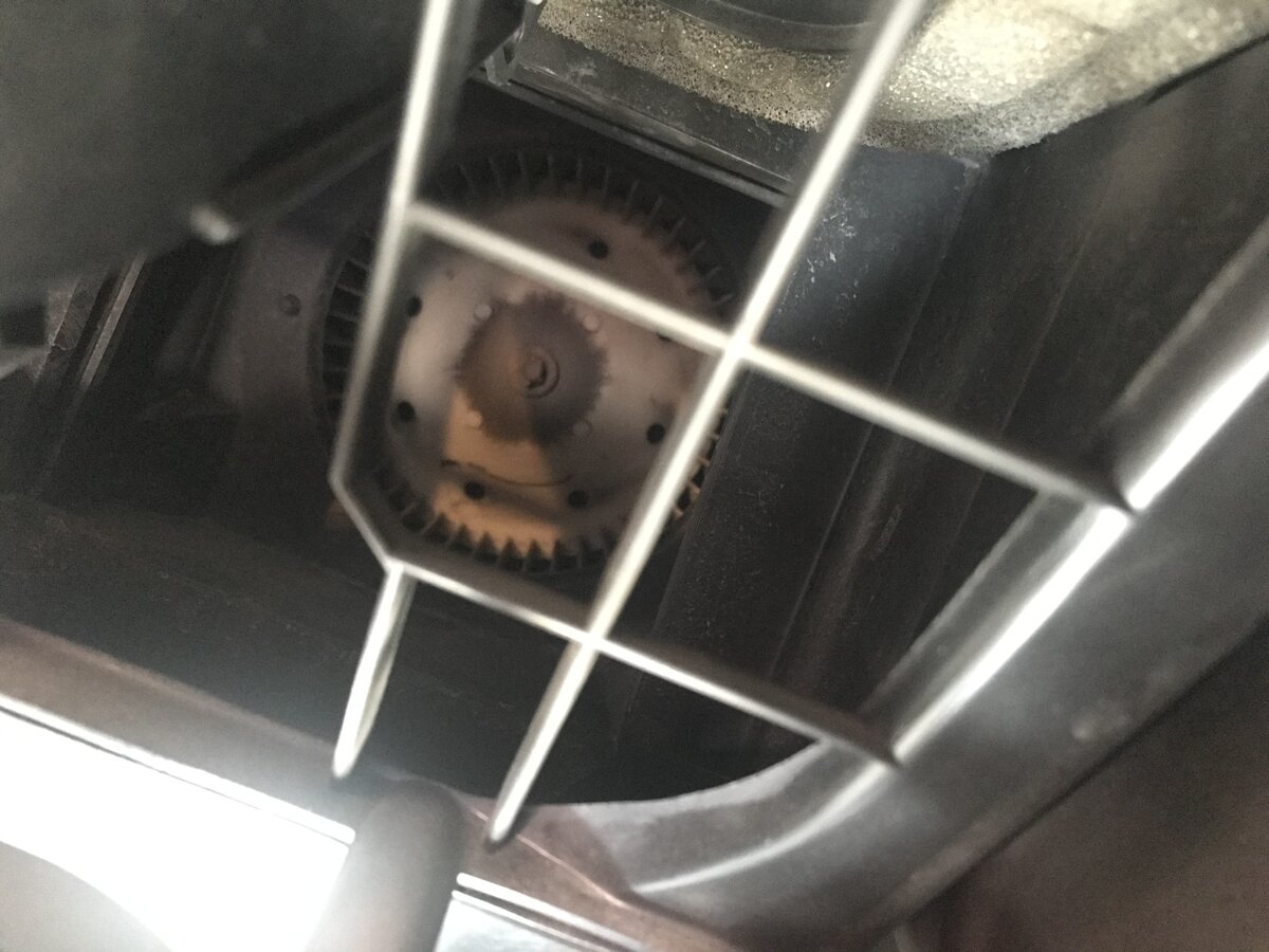

Hey folks. My 95 Explorer has well running regular AC, but just this past week when I set it to MAX, it changes over and blows fine for a few seconds and then slowly something closes and no more air of any kind blows. You can feel something slowly closing as the air goes from blowing hard to just a little and then zilch. I was at first thinking something in the blend door or actuator there, but I get *no air at all* in the Max position after the first few seconds, so that didnt make sense to me (i mean, if the blend door was failing wouldnt I just get normal AC? Or am I wrong?). any ideas? Sorry if this has been answered, I looked around for AC issues but since I dont know what's broken I may not have searched for the right thing. Thanks
