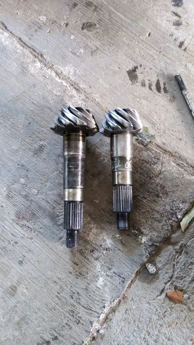

Splines where the same and the gear size is different because it's 4.56 instead of 3.55.Looks like even the splines diameter are not the same too
As well as the overall gear shape.
So what the Jeep axles do share with Ford?
