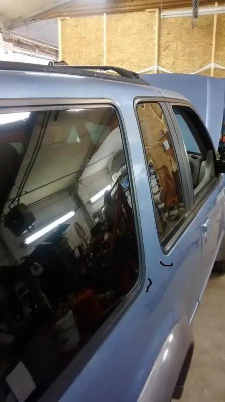

There's my windshield, if you look in the second pic you can see the wave across the top of it now
This is the drivers side. Look top and bottom of the C pillar right between the two rear windows. I tried catching the light right so you can see the ripples and dent. (Excuse the flaking paint on my wheel, it was a rough winter and I haven't sand blasted and repainted them. Lol)
This is the pass side, not as bad but you can still see it

those dents you see are from the factory when they stamp the 1/4's. how do i know this? years ago when i was doing the bodywork on my truck, i saw them as well. my buddy even gave me **** for not fixing them. this was when i had the stock driveline in and not the one i have now.
Those aren't factory on mine 3 days ago my 1/4's were flawless. I owned a body shop for 15 years so I'm particular about where and when every ding or scratch comes from. They are more pronounced in person than I can get a pic of.
no dents
I have no dents or marks on mine. My truck has apparently had body work done. I found out in December when I removed the rocker panel molding to install LED strips. Looks like the dog leg area was done on my truck, both sides. I could see where it was seemed together.

if you are talking about these spots in black
those are from the factory stamping the 1/4 panel
if you look at my truck you can see the beginning of the waves from it. those have been on my truck since i bought it.

I got confirmation on what's going on with mine tonight. My buddy with the 5.0L swapped sport was behind me and he said when I launch it you can see the frame and body twisting from the rear. I guess my rear bumper looks like it's separating from the frame so I must have broken a body mount or something else. Hopefully it's an easy fix with some urethane body mount bushings.
