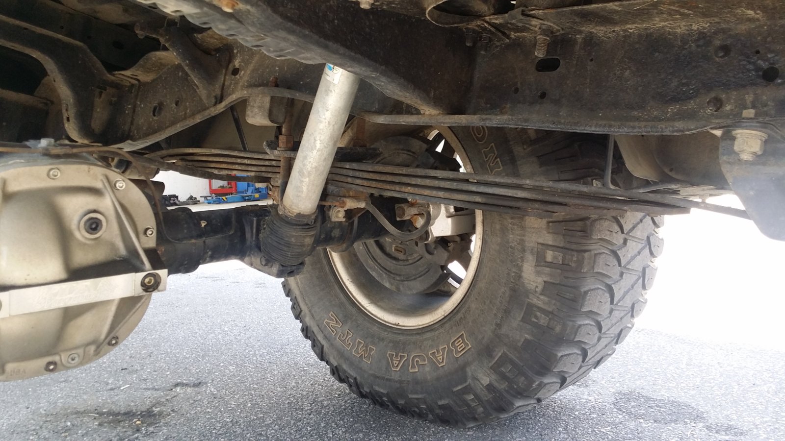

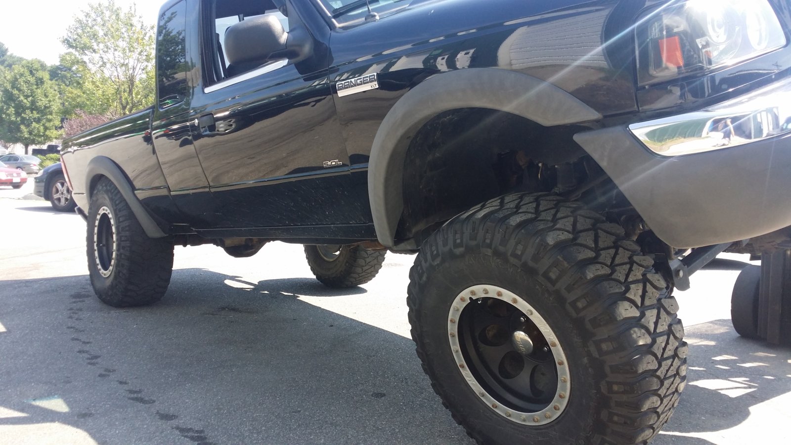

My ranger is factory spring over with explorer leafs + 1 extra leaf now (about 3" lift over stock ranger springs). Now I also have lift shackles which give me another inch but I removed the stock 2" blocks. Basically im setup like a soa explorer now. Here's a pic of how negitive my setup will go and a pic of the droop.
Lol that first pic almost looks like my springs now with the truck just sitting level .... I've got to change them soon thinking about making a custom shackle and going with the ome ARB lift springs. Two inches of lift iirc? And it should still ride nice. I got the #1 bars swapped in today it has improved the ride with the tt and definitely look more stout than my old b bars.i would highly recommend this to anybody doing a tt as they should last longer especially with the weight of extra off road goodies up front.
