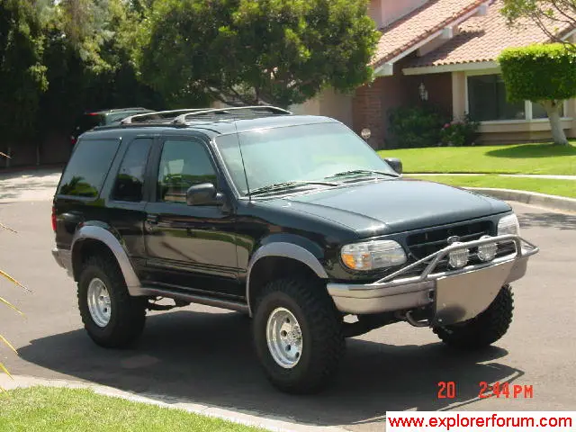

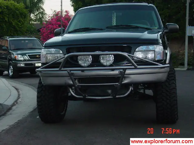

I just wanted to let you all know that this past two days i've been working on a prerunner style bumper. I decided to leave my stock bumper because i wasn't sure if the bumper i would make would be strong enough to be on its own. This is my first time trying to do something like this so the next one will be much better. I basically just used a hydraulic bar bender from harbor freight, 220V Mig welder, grinder, and pipes and plates. Overall I spent around $40 in materials. So pretty good for a grill. I'll post pics up this week.
Here's my pictures. This is my first attempt. My next one will require my stock bumper to be taken off.
man that looks damn sweet!! i want one! lol
sweet
Wish I could find one like that for a 93, mine has factory driving lights, and I do not want to take them off. Good job on yours though!!!!:bounce:
No company really makes one for explorers so in order to get one you would need some shop to fab you up one and they cost from 375-500 dollars to make so I decided for that much I better just try to make one myself.

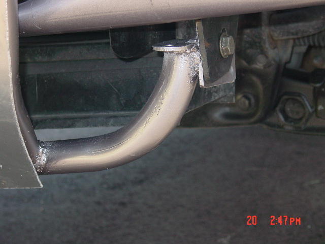

Those look very nice, but I am wondering how much of an impact they could absorb since they are only bolted to the bumpers it seems?
Do you have any pics of the mounting points?

I'm glad you are all interested. I think me and my friend are going to start making some to sell but i need to improve on my welding first before i start selling. As for impact, i have one mount to the frames.(The same mount as my manik brush gaurd) and another set of mounts to my bumper. Just to add extra stability. With the just the frame mounts it held up pretty well. Of course, it won't be as strong as if you took off your stock bumper and added more frame mounts which I am currently working on. But this requires cutting off your ugly frame mounts .
As you can see in the picture, I use the same mounting plate as the manik grill gaurd. I'm making another one that can be bolted directly to the frame.
