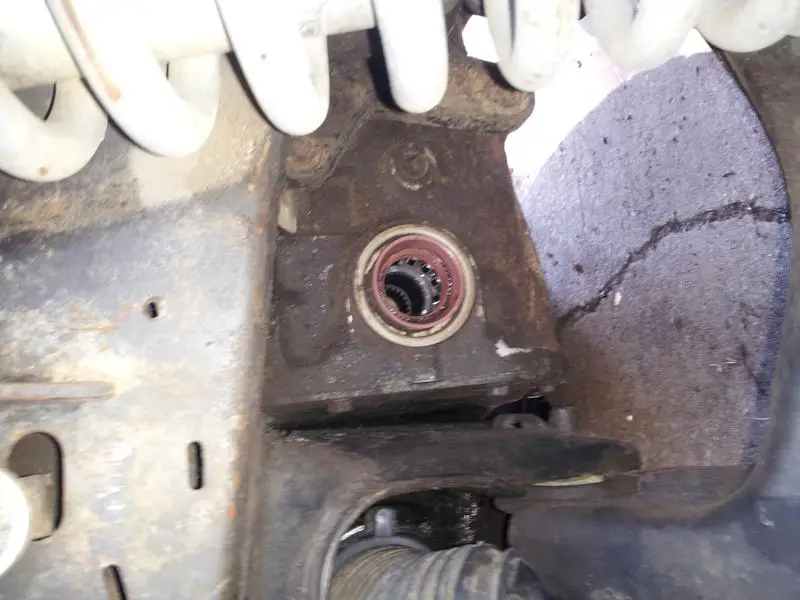

Ok, so hmmm. Looking at the axle seal (replaced in 09), the diff was wet on that side, and the lower half of the cover was wet. I wasn't sure if it was from steering fluids caked with dirt, or diff fluids, or C/V axle grease.
So.. what do I do? I pull out the new trail spares. All good. Run and get a new axle seal.
Pulling the old seal with a seal puller is a cake walk. Installing the new seal with the coil springs in the way... made me want to set fire to the rig. An hour later, a couple bleeding knuckles, and it's in with no harm. Phew!

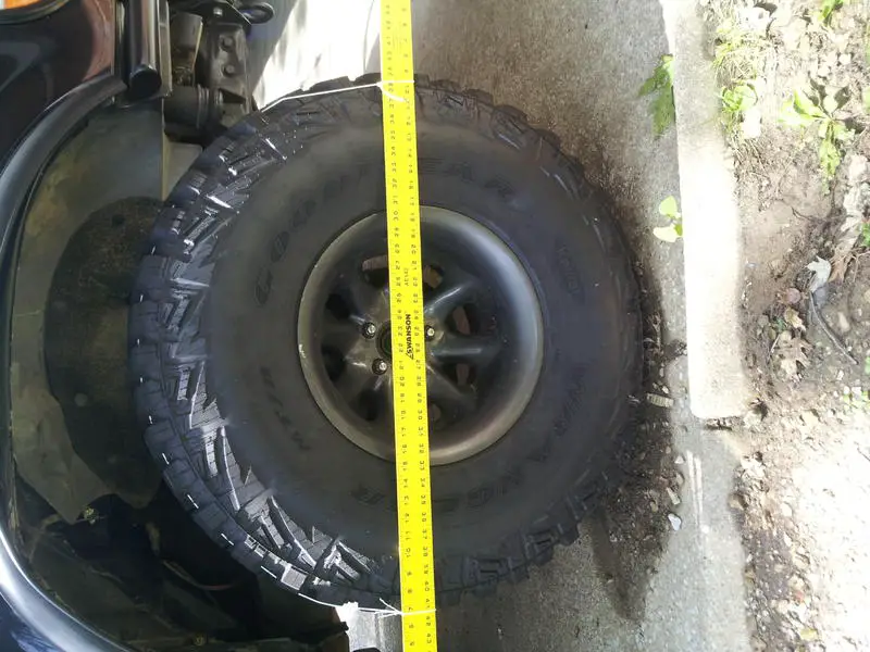

I installed the new C/V, and the new hub. Put it all back together, and look at it from the front. the tire seems off. Like somehow I moved the Toe outwards on one side. HUH? Wut? How can this be? I didn't touch the TRE's. :scratch:
So to ease my mind, I went and got two 4' straight edges, and did the tire measure trick. Measured the distance behind the tires, then the fronts. It was 1/8" out. Perfect!
Guess the heat got to me, and I was seeing things. LOL! That's just how this rig has always been to me. One thing always turns into 10 others. I didn't want to take a chance, so I feel better at least it is fine. :D

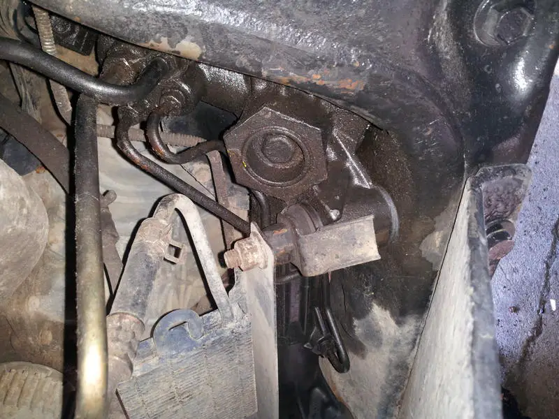

I didn't find any wetness up high, and it seems the rack itself is leaking by the inner TRE. :( So that's the next project. Ugh...

#1- Wet rack area
#2- Old Front axle seal

#5- Checking the toe
