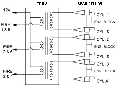

P0351 Ignition coil A primary/secondary circuit malfunction
P0301 Cylinder 1 misfire detected
P0305 Cylinder 5 misfire detected

I went to pick up the vehicle and drive it just down the street to work to change the coil pack. NO CEL on, and the thing ran fine. Put on a house brand coil pack and it ran like crap. Put on a BWD coil pack and it still ran like crap. I should also say that just last month I replaced the plugs with OEM Motorcraft plugs and put on BWD wires.
After testing all 3 coil packs with a multi-meter all 3 had the same exact readings. Original coil pack must be good, right? Reinstalled original coil pack. Spark still VERY weak on cylinders 1 and 5. Cleared codes many times and still comes back with P0351, but no misfire codes. Installed new Crank position sensor. Same results. Unplugged PCM and opened up, looks fine, pins look good, plug looks good. Slathered a bunch of dielectric grease on plug and plugged PCM back in. Same results.
I was pushing on the plug with the engine running and BAM! the thing runs like a champ. Wiggled it again and back to running like crap. Gave the plug a good smack and BAM! runs great again. Test drive around the parking lot and no problems at all and NO CEL on. Left it running for 5 mins while I went into the store, came back out, misfiring again and code P0351 is back. Bad wire in the harness from bank 1 and 5 on the coil pack? That's the only thing I can think of.

2nd question, what the hell else can be causing the P0351 code?
