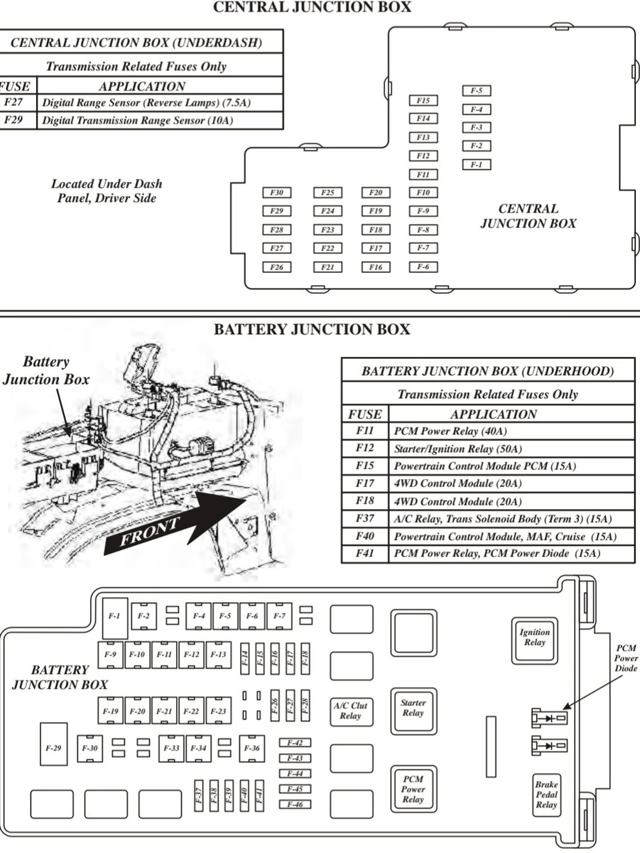

Normally I would say your overdrive sprag went out, but if you have replaced the transmission and it is still not working then it's likely an electrical issue. Usually you would get codes though. Maybe you should check some fuses.
Normally I would say your overdrive sprag went out, but if you have replaced the transmission and it is still not working then it's likely an electrical issue. Usually you would get codes though. Maybe you should check some fuses. View attachment 434685
Checked fuses all good. Trying to chase an electric issue any ideas
