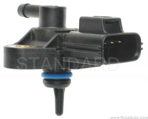

fuel rail pressure sensor

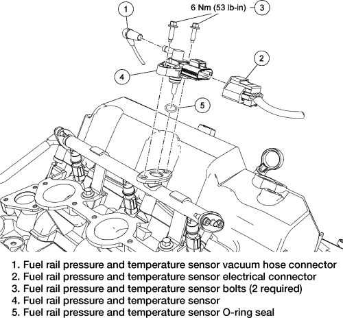

There is a pressure/temperature sensor installed on the fuel rail that provides data to the PCM to control fuel pressure.
Here's where it's located on a 2004 Explorer.
It's quite a coincidence that it failed at the same time that you changed your oil. The failure indicates it could be an open path. Perhaps you knocked it loose. Check the electrical connector. Also check the vacuum hose connection and hose for splits. It provides a pressure reference for the fuel pressure output signal.
Thank you StreetRod for the information. I have notice the past few days while driving, the truck misses like a fuel filter would need to be changed. Doesn't happen all the time. I don't think I had hit it while I was changing the oil, but I do suspect that maybe a vacuums line is either cracked, or need to be replaced.Any more information you think I could use, please send it on.
Ok, I had looked under the hood earlier this afternoon, and had to admit, I didn't see the sensor. I had even run my hand along the the rail and couldn't even feel anything. I did look @ the hoses trying to find split ends and unplugged a few connectors and reseated them. Right now the truck seems to run a little bit better. The picture look similar to my motor StreetRod, except I couldn't find the fuel rail sensor.
