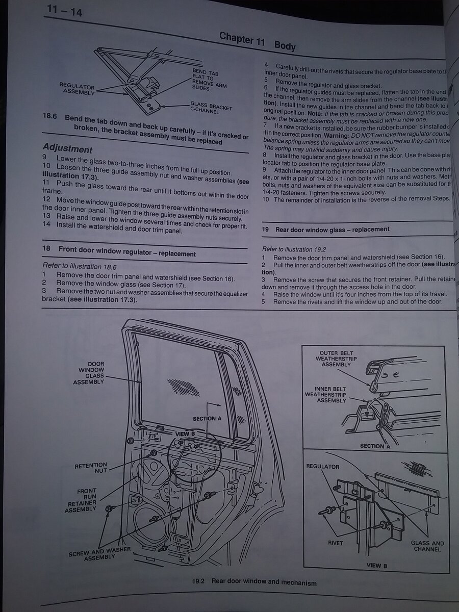

These windows are so stupid toutchy if they are mis aligned even a quarter or even possibly eighth of an inch off it will either jam or just whine without moving. Just messing with the speakers or trim could throw it way off. Take everything apart and start over. That spring needs tension also really hate the gears on these for this reason.
I also bought two brand new motors I tried putting one new motor in the old regulator didn't work I put one of the new motors in the new regulator did the same thing... Maybe some C-4 might help it...lol
