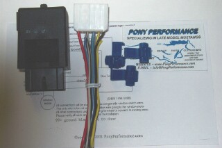

Odd question for you, do you have auto down on your passenger side? This was a popular mod a lot of people were doing back in the day, you take a auto down module for the drivers side and wire it into the passenger side. If thats the case, i highly doubt that they secured it well into the door and if you beat those things around, the IC chip pops off the board. If you have auto down on the door, locate the module, its about the size of a pack of cigarettes, unplug it, slip a 15 amp fuse into the 2 larger spades on the connector and give it a shot.

I had the same problem on my 94. Turned out to be the black module box located just below the light in the door. I read where it controls the one touch button and took it off added a 20 amp fuse in its place 3 years later no problem.
I agree, if you still have the door open, take a look in there for a express down module which looks like this
if you see it, unplug it, jam a 20 amp fuse into the spot that it will fit, tape it up nicely, and consider it a job done.
Sorry, but can you explain this a little better? I think this is the problem with my window. I don't understand what you mean by "jam a 20 amp fuse into the spot that it will fit".
Thanks.
Mike
You place a blade fuse 20 amp where you unplug the black module. The fuse fits into the slots perfect. You can see where it lines up. Then tape it up real well as I did mine and no problem.
Thanks. I appreciate the explanation. I'll have to give that a try. Sorry I didn't understand the initial post.
Mike
