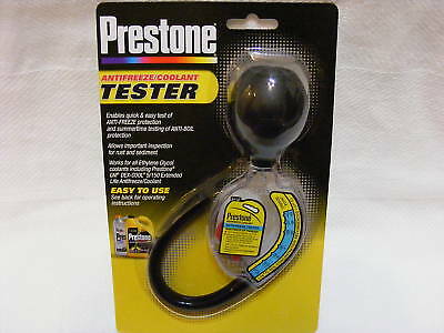

Why not target a slight excess of coolant for winter protection and simply add 1.25 gals. straight coolant/0.75 gals. distilled? Whatever the result, you should be >>50% coolant with some added protection.
Prestone AF-1420 coolant tester is inexpensive, easy to use, and available at most AP stores.

4.0L OHV and SOHC both list a 7.8 quart cooling system capacity. IIRC, approximately 2 quarts of water remains in the block after flushing. To get close to a 50% mixture, add 1.5 gallons of undiluted coolant and top off with distilled water. Prestone's AF-1420 coolant tester is inexpensive and available at most AP stores.

I do recommend you test it after running it up to operating temp once just for the peace of mind of knowing what temp your protected to. I have a Prestone tester I've had for many years.
Wow, small world. That's the exact tester I've had for years. Which raises a question I've always had about that tester. After i use it, I clean it out with distilled water, by basically sucking clean distlled in, and expelling, repeating the process several times. Should I be cleaning it with dawn and plain ol water, or am I doing it ok? I don't want to ever get soap residue in my coolant system.
I've always just rinsed it out with plain water. I see no benefit to rinsing it with distilled water. That would have no effect on the testing and a drop of plain water isn't going to contaminate your cooling system. Testing is a specific gravity thing.
