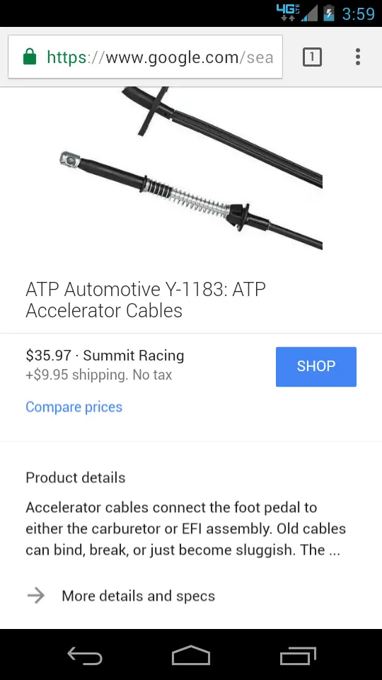

Found this with a quick search

Thanks for looking. Has any tried the above cable (ATP Automotive Y-1183) on a 5.0 explorer? I checked a couple sites and they don't list it as compatible with a 1999 Explorer Limited V8. It looks like the socket end would fit the ball fitting on the throttle body. However, the socket end on the original cable has a rectangular plastic body which the cruise control cable clips onto.
These are not direct replacement throttle cables you're seeing on the auto parts' websites. At best, they would require some modification to work on your vehicle...which basically gets you right back to where you are right now. Junk yard is your best bet...
