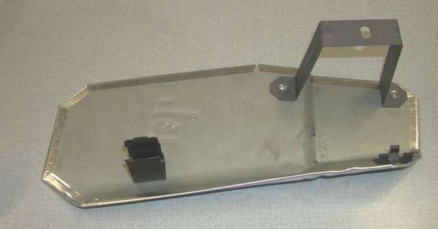

First question, while i was on the journey of replacing my one O2 Sensor my dad found that my heat deflector shield for the tranny is just kinda floating in between the cat and tranny. Were does it attach to or is that how its suppose to be?
Looks something like this...

To answer your fist question just push the heat sheild toward the tranny untill the clip
snaps around the pan and trany .

To answer your fist question just push the heat shield toward the tranny until the clip
Thank you for posting about this, but the thing is there is nothing for it to clip to, i've tried and i can't feel anything for it to clip on to.
It just pinches the oil pan to the tranny .
It only goes on about half an inch .
sweet, after it stops raining i'll go down and put it back on, i figured it was probly something that easy, but at first glance it didn't look like thats how it did it, thanks
In my new one, it also has a screw hole and the bolt which holds the vacuum modulator is extended to hold the heat shield as well. That AND the clip referred to as well. Here's a pic of it..
I'm not certain but I think FORD has possibly re-engineered it. I ordered my new one in January and it got here in MAY!
I'll stop up sometime and stick the shield on. Mine was a pain too.
well i got it on and its being a pain and it keeps poping of, i'm gona try sometime later to get to stay on.
