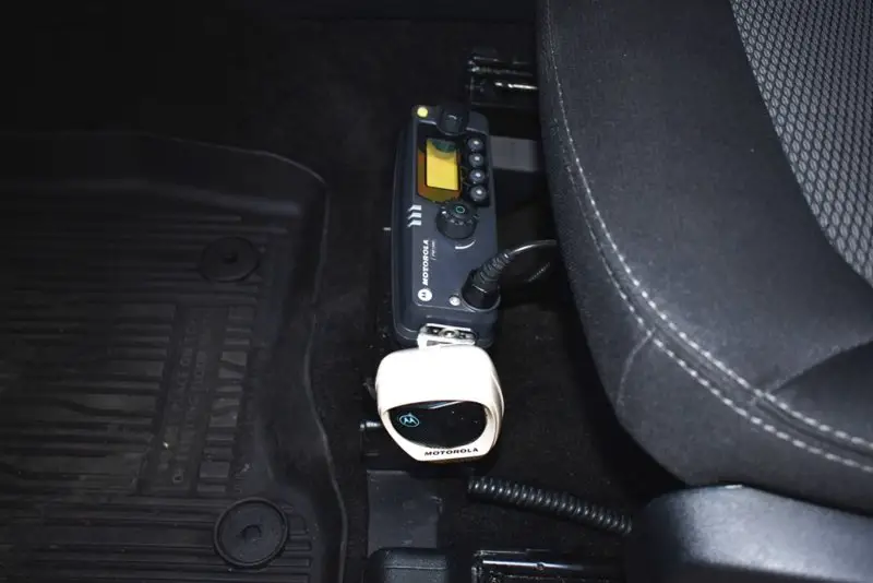

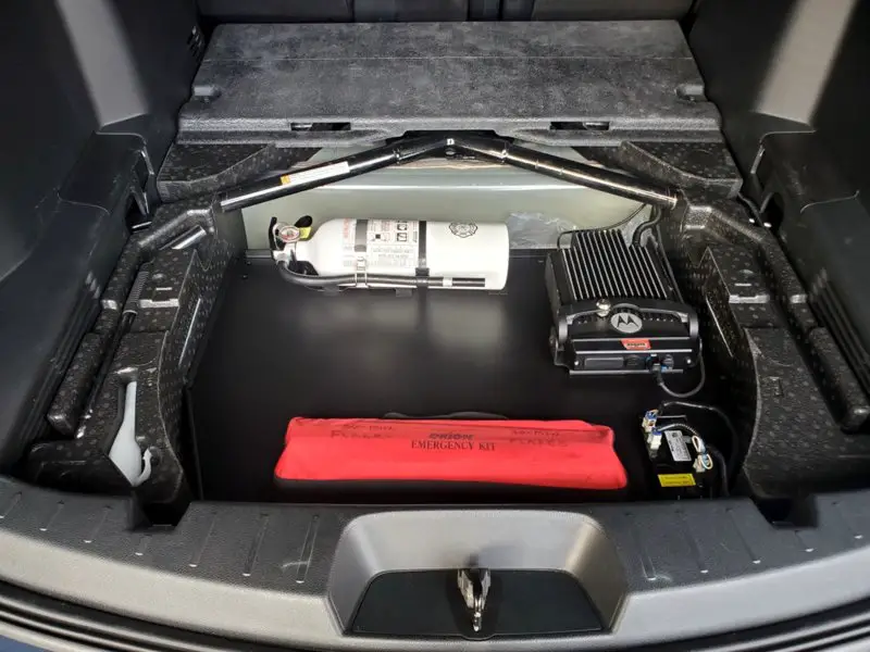

I was able to mount the control head and mic just in front of the driver's seat (see pic), using a modified version of a base plate for a police computer pole mount. I also mounted the actual radio unit in the rear cargo area, using a Setina PIU equipment mounting tray (see pic) that fits over the spare tire well.
