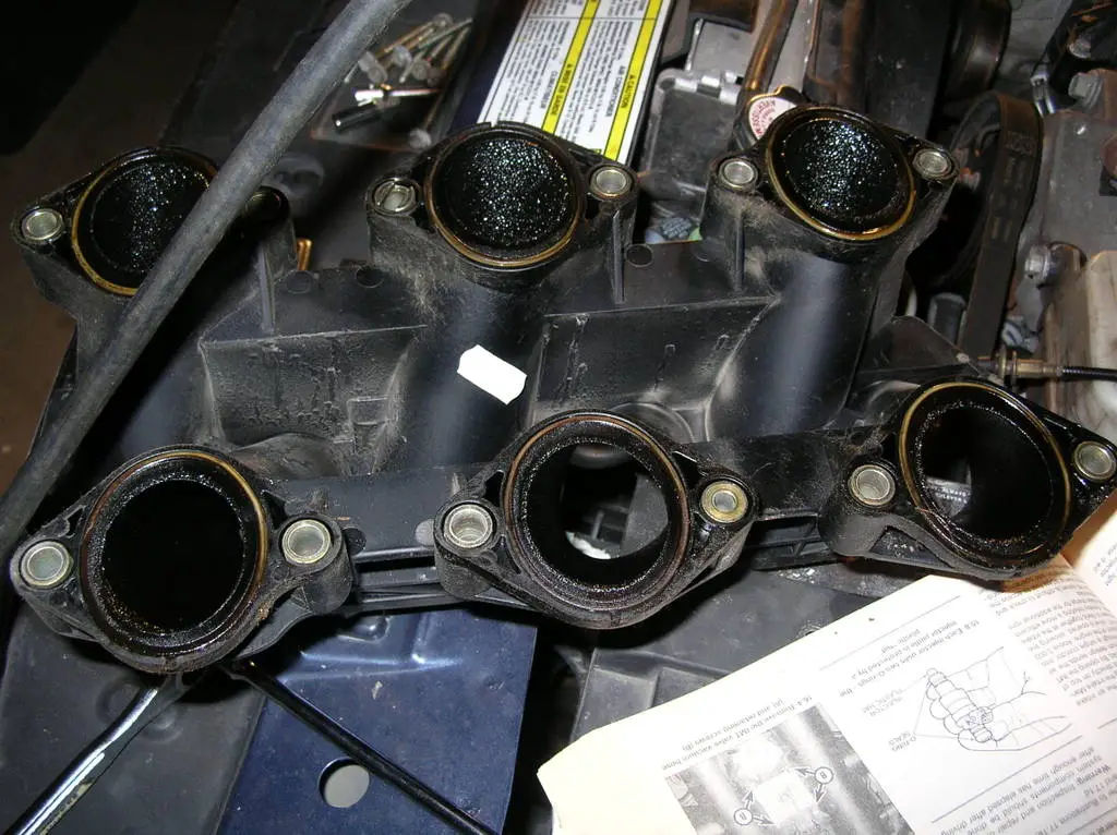

I think this is going to be where our problem was. Once I was able to inspect the gaskets, I thought to myself... Woah, this has got to be it. The gaskets were so stiff, it almost felt like they were brittle as I was removing them.

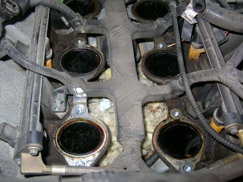

Here's a couple photos of what it looked like when I pulled the lower intake off... I'm guessing the mouse nest is optional. LOL
Just for reference, this vehicle is a 2000 with the 4.0 SOHC in it.
Note, in the photo below, the brownish/greyish rings... those are the gaskets. See how the inside (towards the middle of the manifold) and the outside (towards the edge of the manifold) of each gasket looks different? This must be where the engine was sucking air.

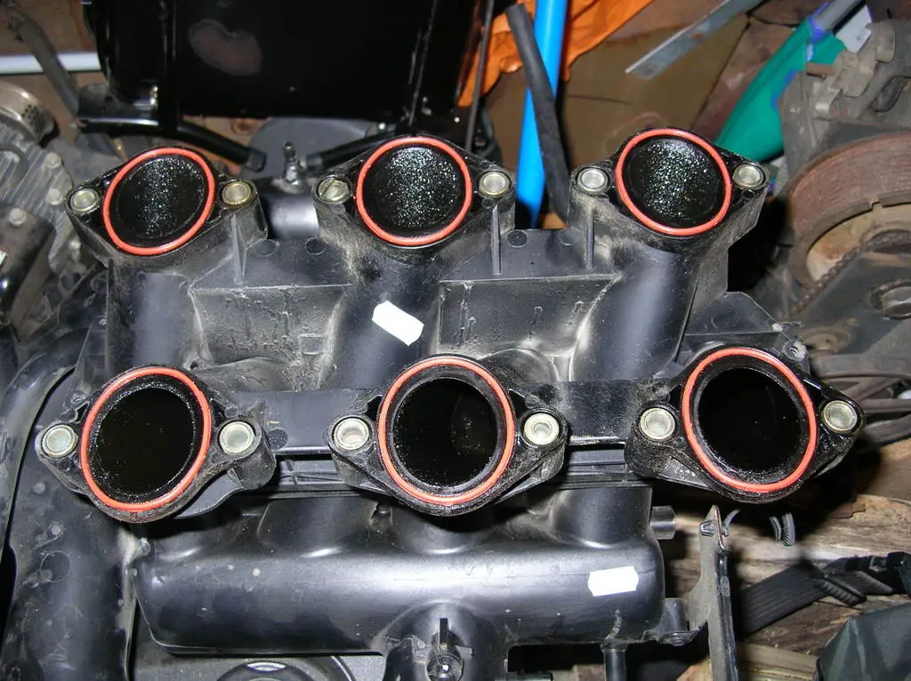

Here's the lower, with the new gaskets installed.
I'm pretty confident that I've found the problem. Again, thanks to everyone that weighed in on this topic.
