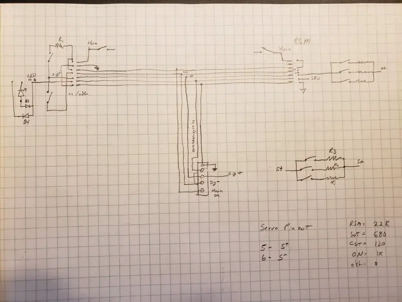

I did a lot of troubleshooting of the cruise control buttons recently. I bought a new set of switches and created the attached wiring diagram, hope it helps someone else. I did find out that the connector on my right side switches was flipped, that was the whole problem. The dealership I bought the EX from apparently replaced the switches and plugged that side in wrong.
Test if your buttons are wired up correctly you can measure the resistance across pin 5 & 6 at the servo plug. You should measure the resistance noted on lower right corner of the diagram for each button press. That will tell you the buttons, wiring & clock spring is good.

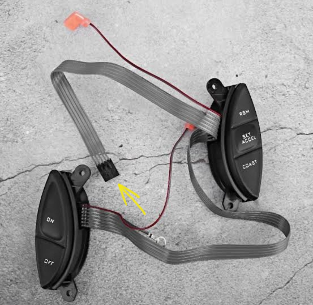

Please, do you know which are the positive and ground pins to turn on the button lights?
I need to test some

Possibly the answer is here, but I can't identify
^ I am also having difficulty interpreting that diagram, but it looks like it is showing:
Pin 1 - Horn
Pin 2 - Cruise Control Signal Out
Pin 3 - Cruise Control Signal In
Pin 4 - Bulb +
Pin 5 - Bulb - /ground
I don't know which end of the connector is pin 1.
