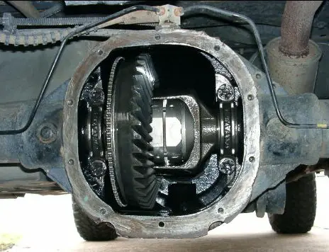

Huh? In the front ABS rings are in the hubs. On the rear the ABS ring is inside the differential attached to the Ring gear.
My rear differential. You can see the ABS ring to the left of the ring gear.
