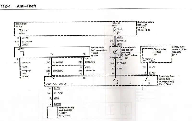

I had the dreaded "door ajar" issue and upon inspection of the wiring harness inside the driver's door, several wires had bare places , I put electrical tape on each individual one.
Now this is my problem, the door ajar light stays on all the time, the doors don't chime when opened anymore and the security alarm doesn't work anymore, although the theft light is flashing.
I checked the Fusebox under the hood , fuses # 42 and # 43 appeared to be blown, checking with a test light.. But switching them out with other same amp fuses, the fuses are not blown. Also checking the inside Fusebox , fuse numbers 4,6,7,15,18 and 19 are not lighting up test light.. I haven't had a chance to pull the fuses to see if they are good.
Sorry, if I don't make sense, I've not had much experience with electrical problems, any input would be greatly appreciated
