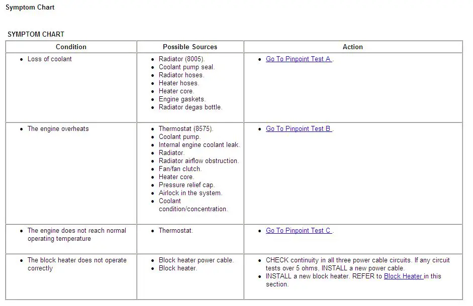

Here's the ford procedure:
Thanks guys! It was the thermostat! Changed it and flushed the radiator out and nothing but mud came out. Thanks for everything. And thanks Cross6 for the Ford Procedure. I will save that.
