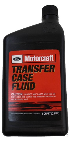

Another quick question, I've looked around and seen differing opinions on this online. We are going to be doing the front, rear differential fluid changes once I am able to pick up some Amsoil 80w90 synthetic from my local shop that does the work we can't. I was going to pull both covers to inspect them just to be safe since I am sure the original gear oil is in both. I've read that for the front you have to drop the entire setup in order to pull the cover then I've read you don't have to. I am confused on what the truth is here. I know the rear is easy enough to do and I've already ordered the gaskets for both differentials. Doesn't bother me if I can't pull the front cover but if I could without having to drop all that I will but if not then just using a hand pump to pull out all the old gear oil is good enough for me.
I am really trying to inspect and replace what I can on this since it will have to last me probably for the next 10 years at least. I've picked up just about everything I need to replace except spark plug wires, pcv valve, couple gallons of Valvoline Zerex G-05 and the Amsoil as described above.
What I've bought so far is...Plugs, Fuel Filter, Air Filter, 75w140 Valvoline Syn, 2 Quarts Valvoline Transfer case oil, 8 quarts of Valvoline Mercon V, Wix Transmission Filter and OEM Ford Transmission Gasket just in case since it was 14.99 shipped NIB, Low/High Beam Silverstar Ultras, Full Syn Valvoline, case of FL-820s for $44 shipped off of Ebay, Serpentine Belt and new Callahan Front Rotors w/ ceramic pads..I think that is all of it,lol.
Is there anything else I am missing? We plan on doing this when I get back from Illinois at the end of the month. I don't think I've missed anything...but with everything going on around here been kinda hard to remember everything I need to pick up with a full house remodel going on as well,lol.
Also new tires are going on as soon as they arrive from Cooper's Factory. Replacing some Firestone Destination LE2's. Had a set on my parents Liberty, wasn't impressed with them so got a set of the Cooper AT3's at 116.00 a tire plus 200 dollars in rebates so total cost came down to 354 installed after rebates with lifetime balance and rotate.
Once again thank you to everyone here. Your help on this thread and others has been a great help to me.
The front cover is a no go.

Hope the plugs and filters are all Motorcraft...
Belt get Continental Elite (ex GoodYear Gatorback).
Don't forget the Motorcraft XL3 additive in the rear differential if you have a LSD.
