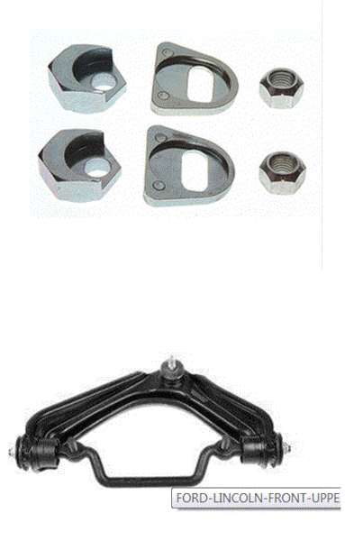

More Information for MOOG T40253

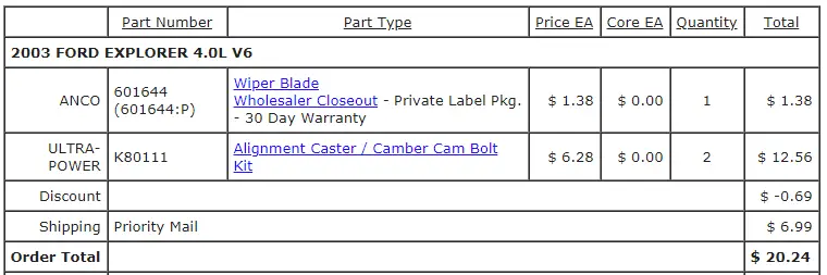

Recently had to go though this myself.
Best to buy them from RockAuto, everyone else way over charges for them.
Remove these:
Install these:
Here:

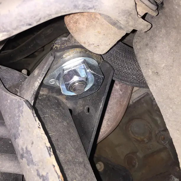

Once I installed them I took it to Ford for the alignment. They were actually the cheapest. $77.53 total.

Remove these:
Install these:
Here:

Remove these:
Install these:
Here:

You don’t know what is the correct position to install the kit? Because in the images shows different positions.
