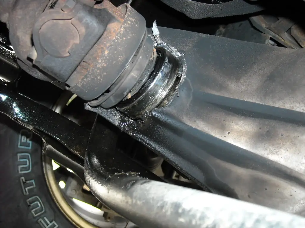

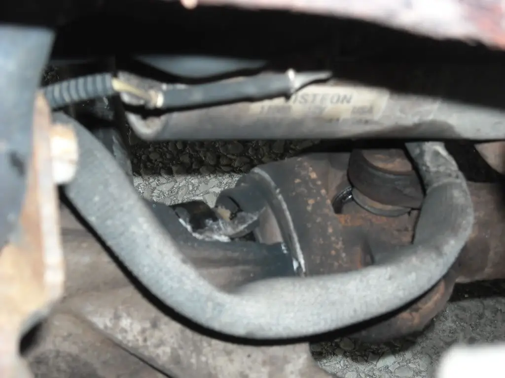

here are the pics...you can see where the driveshaft goes into the diff, half of the metal is gone!! wtf!!
Oh, and theres some pics of my mustang too, but I hope you guys have some suggestions about the driveshaft eating my diff.!! lol

Let me help with putting the pictures here... (nice stang BTW:thumbsup:)
nasty stuff!...
A new or junk yard unit are your only options....Id go for the junk yard unit... Im sure you can find one and will probably get a small warranty with it too.

By chance was it leaking from the pinion seal before? Last pic that oil on the bottom of the diff looks like an old leak was present. Also the bearing looks 'spun' could have been before or after hard to tell.
Just a guess: If there was a leak present that might indicate that the bearings are getting bad and they caused the seals fail, what might have started as a slow leak suddenly turn big and drained the case in a matter of minutes, no oil on the bearings will cause them to fail and lock up, something has to give and i'm only guessing but the bearing race tried to turn inside the diff case, leading to the case to xplode. . .
yea that sounds like a good observation. I never noticed anything leaking before, oh well....whats done is done.
