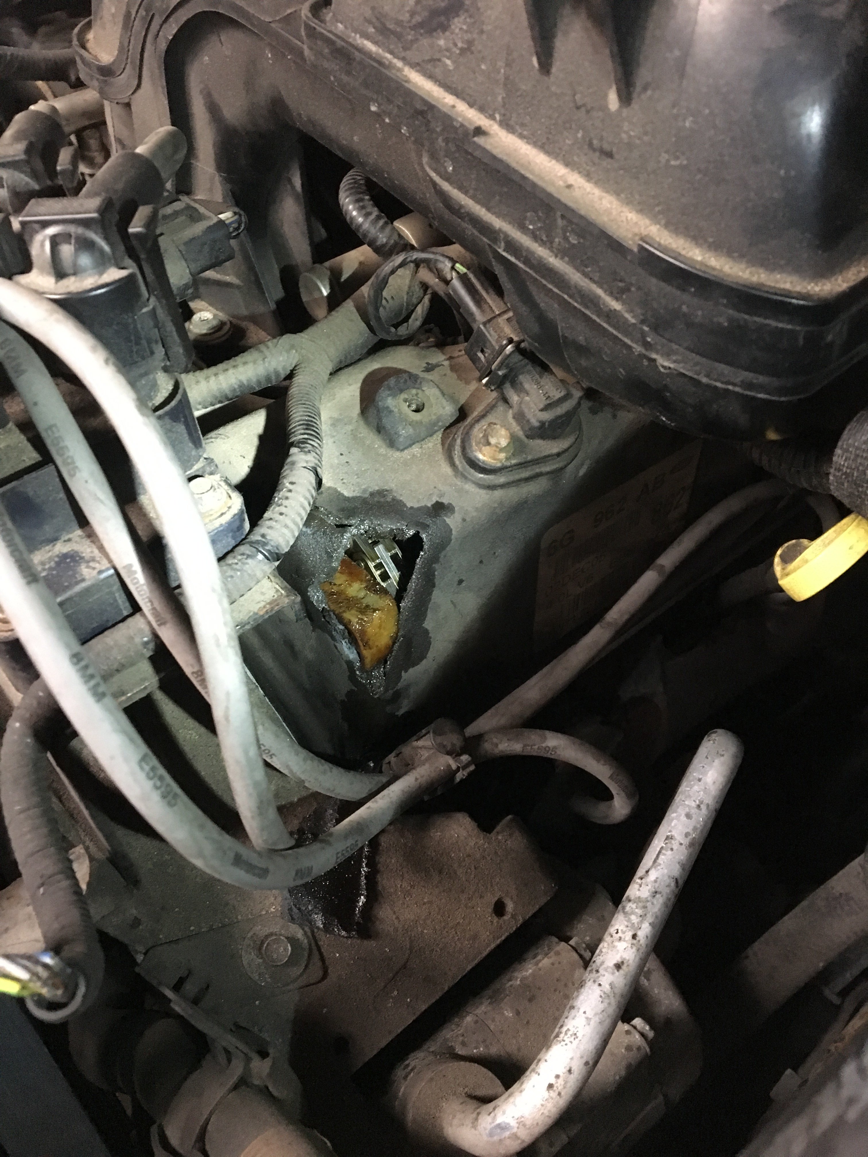

They just fixed what was broken and kept it moving I bet. Did they pull the oil pan to clean the debris from the pickup?
Yes they pull out all debris from oil pan and small parts of broken tensioner.
As long as it's quiet and runs right I'd call it fixed. Did they pull the right valve cover to check that rear guide?
Yes they pull the right valve cover to check that rear guide.
