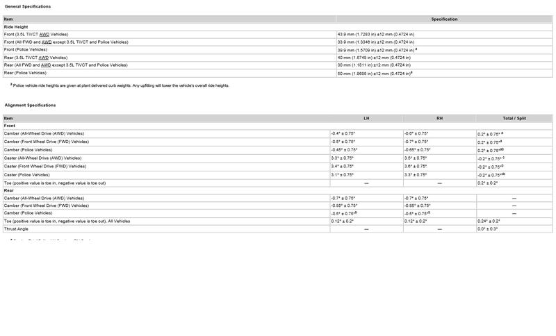

Does anyone know or can anyone point me to Ford's alignment specifications (caster, camber, toe, thrust angle, etc) for this generation? My reference material is pre 2011 and google hasn't been helpful. The local Ford shop checked the alignment on my 2015 Sport giving it a pass. Steering self centering is quite pronounced at moderate and hiway speeds and I think I can feel some scrubbing during low speed turning especially when accelerating. Has Ford set the geometry up with lots of caster and neg camber to compensate for less than attentive drivers or? Anyone have any thoughts?
Attached a pic from the 15 Service Manual.
