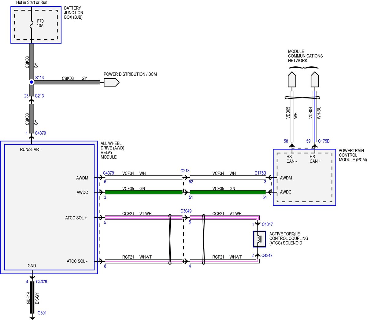

Would anyone know where I could get a PCM pinout diagram? I am trying to troubleshoot a P 3506 code and suspect it is in the wiring harness or connections to the PCM. thank you.
Here you go:
