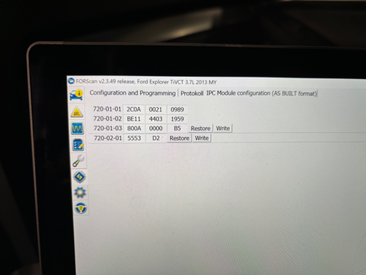

I tried with several code options. The arrows above the aux buttons work, but the aux buttons itself not.
2014 PIU built with aux and mine don’t show up on the screen either. Im missing the module and assuming that’s my issue. I’ve tried everything else. Asbuily shows it there.
I have the aux buttons shown in the screen now. But I can’t activate / deactivate them.
what did you do to get the aux display
2014, my as built has it like that but it doesn’t show the aux switches
Here is, what changes I made.
