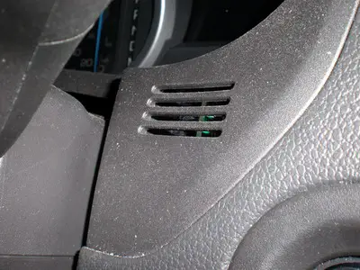

I wonder if it might be the cabin temperature/humidity sensor. Just a guess. I'm not sure how you would test it.

I was thinking this also. Seems the part is inexpensive. Thank you for showing the location, I could not find. I will report back when I figure something out. Thanks!!

Hello. I just wanted to say thanks. I also had the same issue and this was my solution. I appreciate you sharing your knowledge.

Happy to have been able to help out.
