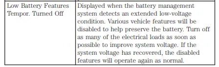

From yesterday, my 2015 explorer show low battery Features Temporarily Turned off when stop at stop sign.
Is that cause by battery? The battery is about 3.5 years old.
If I just start it and not drive it, No this warning!

Now it show 'Low Battery Features Temporarily Turned off' after started and drove a while.
But I can still drive it a long way as no issue.
