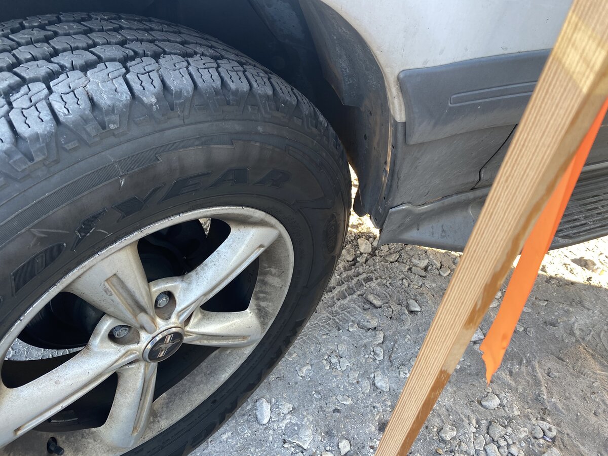

I think your only area of possible concern is the front corner of the rear wheel well, because the rear door is right there. But it seems like you could even cut off a small part of the actual corner of the door without opening up to the interior.

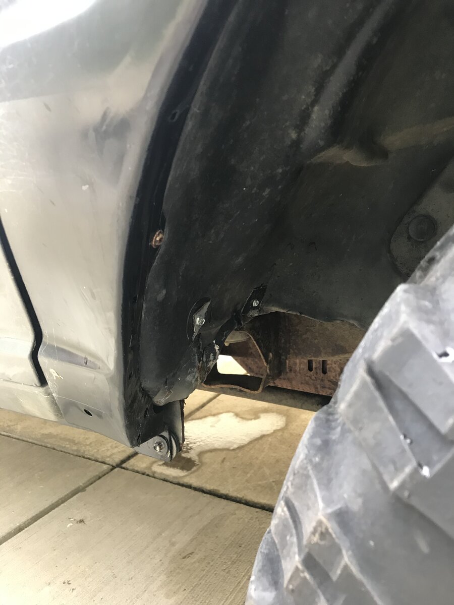

I got 35's on my Explorer after a 5" lift and trimming the front fender back to the first bolt in front of the door. It still rubbed occasionally. The rear is another issue. I think you need some lift to get away from the front of the rear fender opening. No trimming there since the rear door is about a inch away. I am not sure how much lift I have now but I would guess its at least 8", and my rear tires rub on that edge and on the inside of the inner fender when stuffed. I think you would be much better off with 33's max.

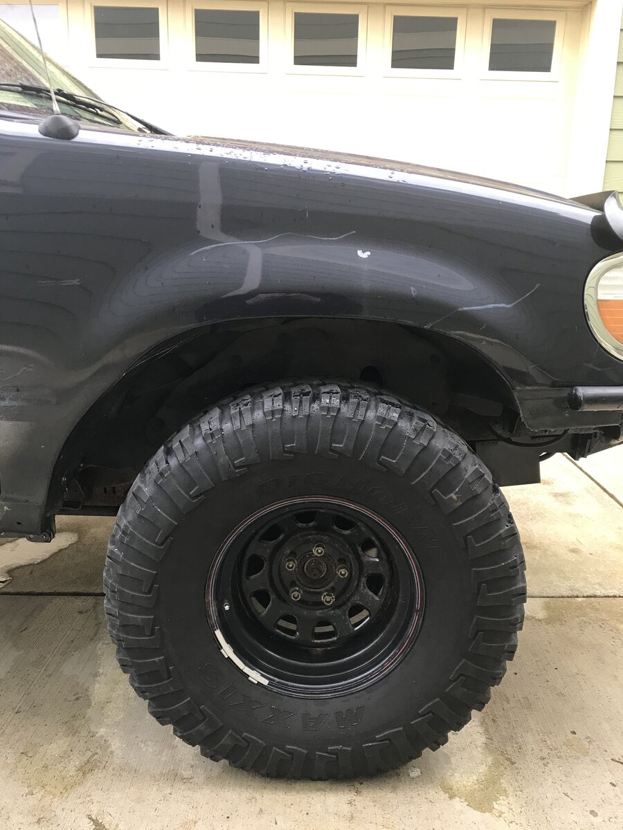

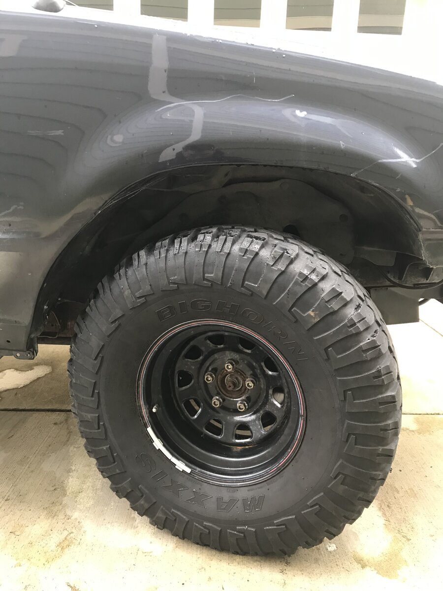

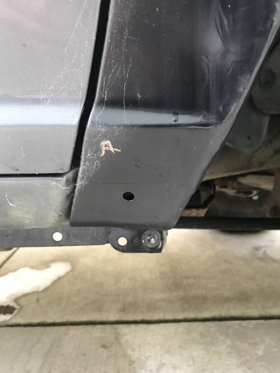

I did a torsion twist, took a hammer to the body, then cut and welded the fender for clearance. The picks are with 33” tires. I haven’t test fit 35’
That looks super clean. gives me some confidence I'll be alright. Even if it isn't as pretty. What's your backspacing?
I don’t know, LOL. I bought them used. I think they are just some standard 15x8. I bought the stock, busted down non running explorer for $340 to make a gambler rig but never took it gambling due to COVID. Got the wheels and tires for another $150 off Facebook marketplace. Now it’s all fixed and works great. Too good to gamble! 😂
