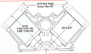

A 351 Cleveland is NOT a "Big-Block"
The 351C is a small-block engine! The rear face of the block and the motor mount locations are the same as the 289/302/351W. What makes the Cleveland "bigger" is it's BOSS 302 style cylinder heads - they are much wider than Windsor style heads. The 351C deck height is 9.2", so it is a shorter block thna a 351W, but, due to the size of the cylinder heads, it's overall width is greater than a 351W.
The engine in the pictures is obviously not a Cleveland, as it has 6-bolt, 289/302/351W style valve covers. The 351C has 8-bolt valve covers, like a BOSS 302 (and 351M/400M). Also, a 351C block has the theromstat location in the block (which the engine in the pictures does NOT) rather than in the intake (like a 289/302/351W).

yea thats definitly a 302 not a 351.
I don't like to beat a dead horse, but I have both 302 & 351W blocks sitting beside eachother in my shed. I've worked with both many times and in conversions on my old fox mustangs.
The block in those pics (after second install), is a 351 Windsor.
Look at the base of the distributor. There is about 1" rise to the base of the intake deck.
On a 302, the base of the distributor is flush with the base of the intake deck.
Anyone who has any familiarity with working with these two blocks will know what to look for. Can't blame anyone for not knowing if they haven't
