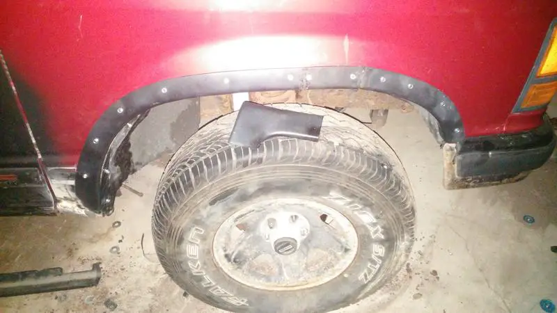

This is a pic of the 94 the day i bought it for 300$ and drove it 200 miles home
