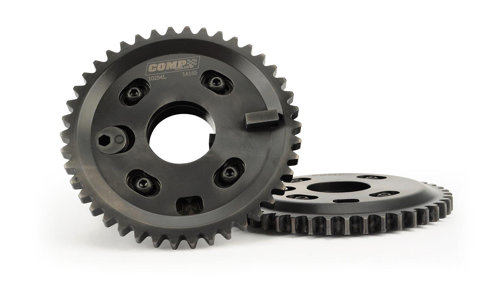

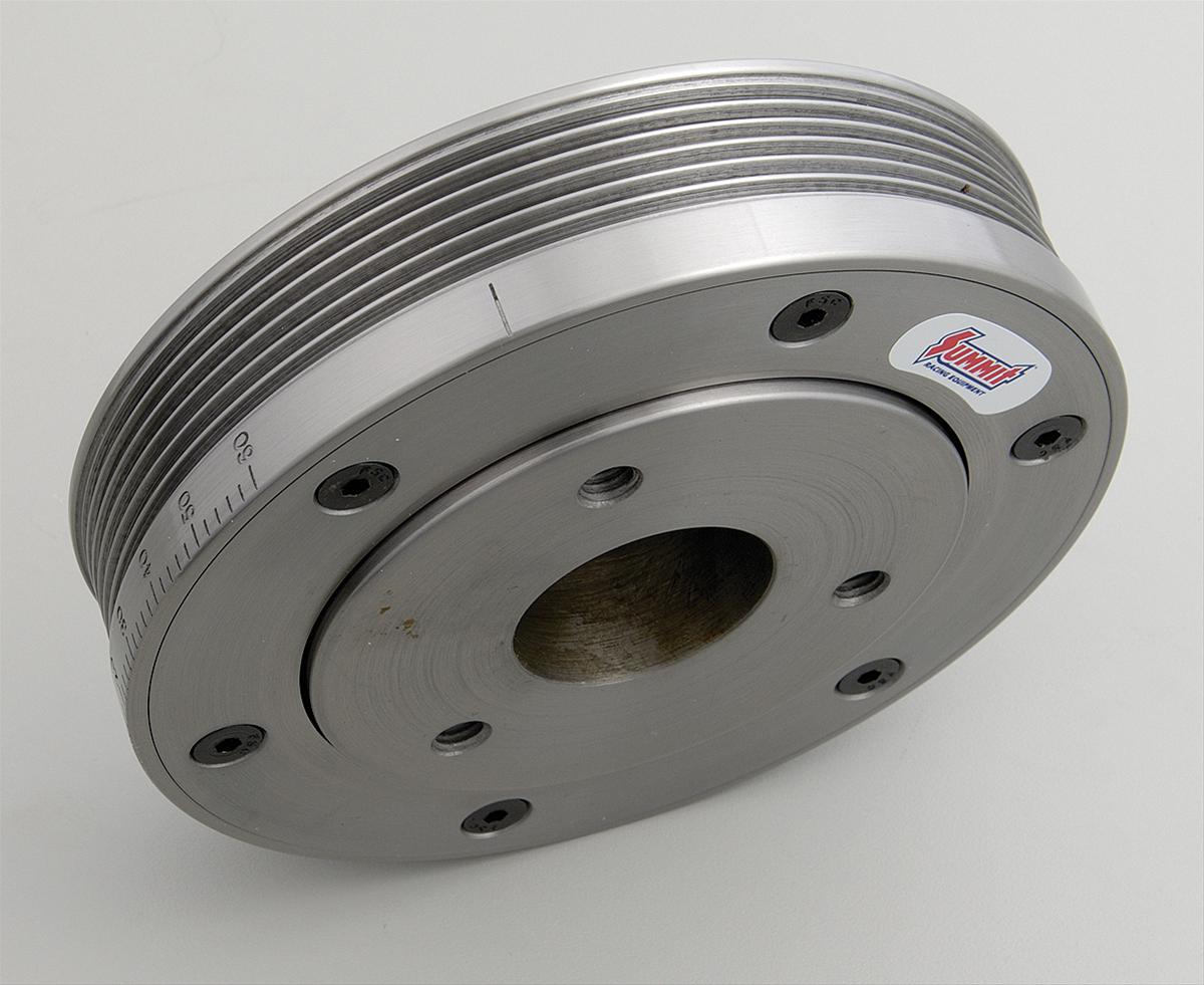

Wanting to swap in these comp cams that have better top end while keeping the low end torque. No reviews on the cam at all and no info on cam swapping in a explorer 4.6 2v. Going to add a summit racing harmonic balancer to the equation for good measure to. Anybody have any advice or help it would be greatly appreciated.
From my understanding I will need the cams, degree service, adjustable cam gears, harmonic balancer, valve cover gasket, Am I missing something else here? Thank you in advance.

Do not purchase the Comp cams cam sprockets, have MHS do the degreeing for you. It is worth every penny... Buy a new timing set for the engine. Make sure it has guide that are metal backed not the cheep plastic ones. You will need new cam bolts and replacement valve springs too. There is no need for the aftermarket high seat pressure valve springs. I believe Speed Pro makes direct replacements that will work with those lobes. Talk to MHS, they will help guide you through it. They also sell alot of the components too!
