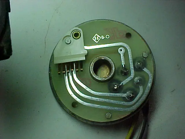

Does anyone think that the problem may be like in this photo of the motor? Could this be intermittent and fixed by shutting the truck off?
By the way, that photo is from the sticky up top...... not of mine. I am just trying to get some ideas before I tear into it.
I'd start with cleaning the range shift motor contacts. There's a thread here somewhere on it.
I'll throw a theory out there that the contacts have an intermittent connection, The GEM sometimes can't see that the t-case is locked in low or high and is cutting power to the TCC.

Also, are these the range shift motor contacts that you refer to?
and
