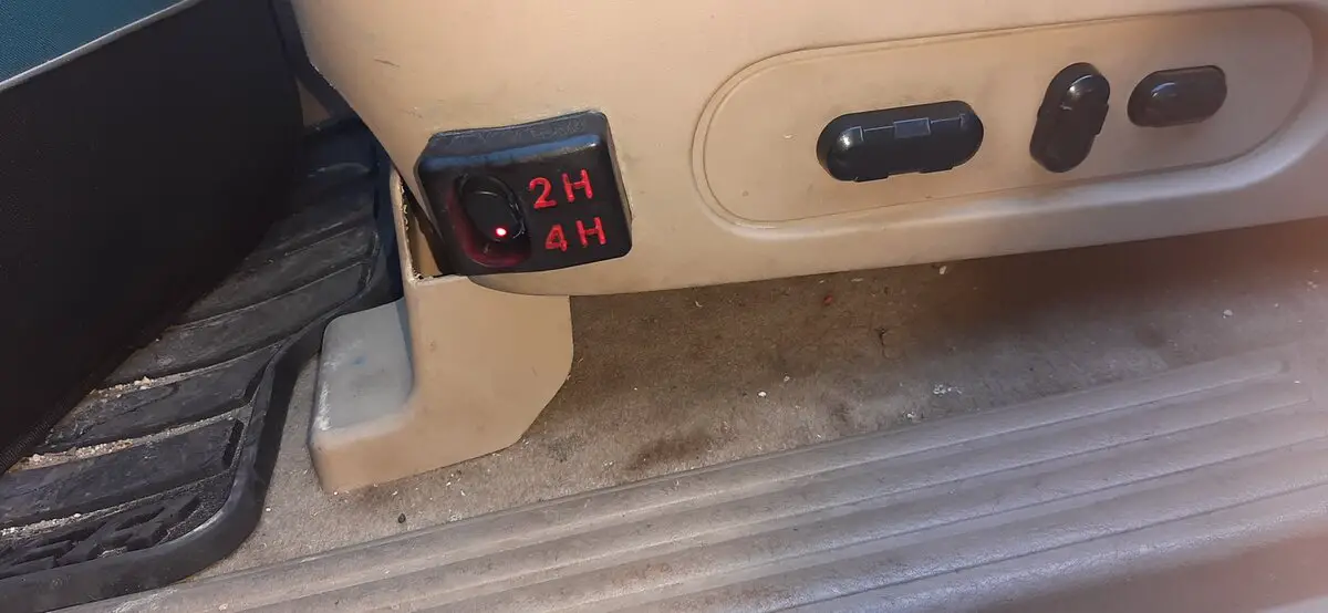

You could also modify the Gen4 to be totally part time 2H RWD.read about the AKA brown wire mode
