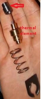

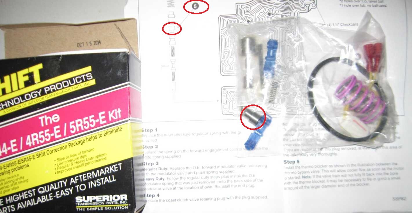

My first thought was the thermal bypass valve, sitting in the valve body, should open at 70°C / 158°F
I am not shure if this valve is still available, i didn't found it. They often fails in the past, oil/bands/clutches get burned.
So i block this valve with a little part, so the oil runs every time through the cooler and the additional cooler.
This part was included in this superior shift kit, but you also can use a matching copper pipe part.
