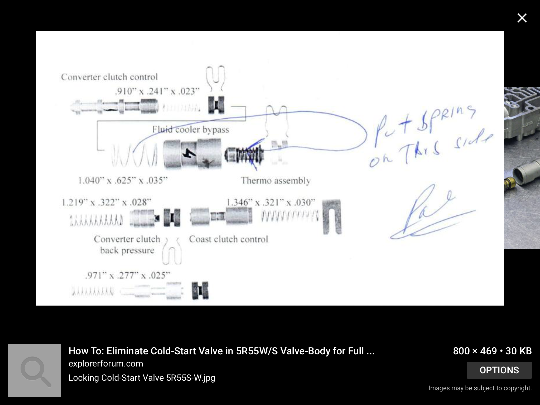

Cant find any information about it, only to block this pasage to gain full flow to cooler.

To be honest you would be better to pin the valve in the open position. If that element fails or more likely gets debris in it and sticks in the closed position you will experience total melt down. Just from my experience. I always disable it on my rebuilds also makes filling and getting proper level reading easier.

Wolfgang, the pucks and check balls come in overhaul kits. Ford doesn't sell pieces. You have to buy a new control body. Re manufactured pieces are just that pieces that will pass a go-no go test will be reused. Common wear items are already being made in the after market with over size parts and the proper tooling to make the modifications possible. Some re manufacturing companies have proprietary parts made also. There are assorted parts like retaining clips and end plugs available through transmission parts suppliers.
Also the A4LD did not use this element.
