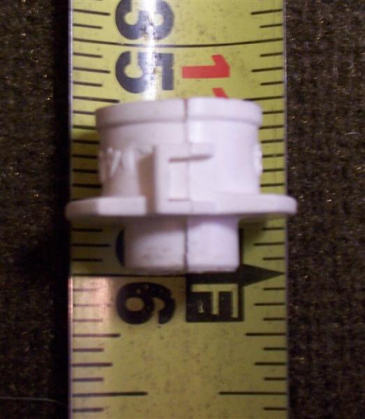

Anybody know part number or discription for autozone or advance auto parts? I have gotten the wrong tool twice from these idiots! My ford dealer does not have them in stock. HELP!!!!!!
Get it from Ford-Only takes a day
Airblue,
Tell the Ford dealer to order you one. I too tried Autozone, etc., Ford is the only place to get it. As I said, save yourself some trouble. None of the other ones fit;)
Dave
Airblue,
Dave
Thanks Dave
Carquest has the right one but they are closed tomorrow. I will take your advice and order from STEALERSHIP monday. I had it in my hand but guy at the counter said it was the wrong one - geeeeeeeez! I did notice a couple of online sites listing a ford tool but said 2004 +.

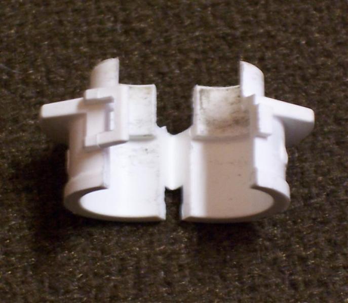

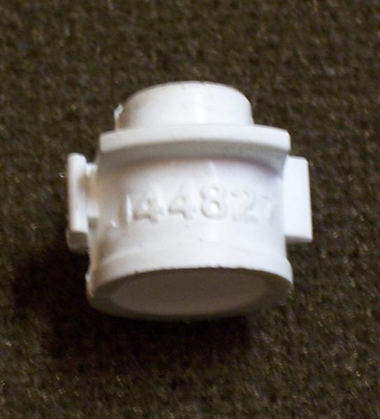

Here's some pics
Here are some pics of mine. Notice the "stubbiness" of it. The problem is the line has a "rolled" place in it very close to the end of the garter spring doughnut. You can't get any of the regular tools between the rolled section of the steel line, and the doughnut section on the other side.
Dave

Stealership
BB,
I got mine from the stealership. I think it was $8.00 or something like that. I wasted three times that much (and several hours) trying to get two or three others modified to fit.
Dave
