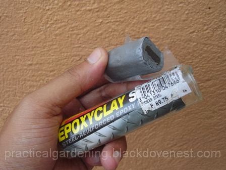

By the time I buy the fluid, filter, new sleeve and fluid injecting device, I'll be out about $100.00 and couple hours effort. On the other hand, I can epoxy that mess in about ten minutes. :) (Yeah, I can be a butcher sometimes!)
