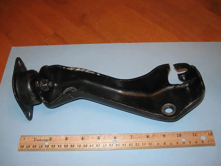

Hi, I just joined and am looking for front differential bracket and advice. The front differential mounts to a bracket. That bracket broke and the whole axle and differential assembly rotates front and back. I haven't been able to find one yet. Are they different from year to year? Any help or diagrams or correct nomenclature would be appreciated.
Thanks. Basically I need all the mounts for the axle assembly on the front of my axle of my AWD aerostar. The differential dropped down onto the subframe and wore out the u-joints on the front driveshaft. When I push up on the differential I can lift it up 2 inches. There is this long piece of metal that has holes that fit over threaded posts and are connected by nuts. There are two bolts that screw into the differential. I don't have it out of the van yet to take a picture.
picture of the part I am looking for
here is the part. I went to a salvage yard that had two aerostars and the brackets on those were broken too. I figured it was a pretty common thing on the all wheel drive models and hoped that somebody made new ones. I put the corner back on for the photo so that it looks more like it should.

I found a couple these brackets (they bolt to each other) at the wreckers today. The first one was broken and the second slightly cracked, but good enough to roll for now. Cost $40 together (I removed).
Hey BrooklynBay
I finally found one out of a salvage yard in Nebraska, and it was in great shape. Thanks for your help and the leads.
