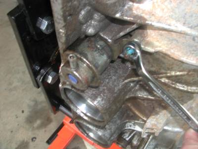

Check your modulator hose... bet you have a leaky modulator...
where is the modulator?? I think its in the pan and its only 20 bucks. can/should this be replaced I think I read a post that said to disconnect the vaccume line
and check for fluid inside I,m gonna do this tommorrow the auto parts place just delivered the filter and gasket thanks
OK passenger side top left on a ranger do i remove the seat or can this be done from under the truck?? thanks in advance
From under the truck. Back end of the heat shield.
sounds like a P I T A theres not much clearance there.
<soft smile> uh huh. You have to remove the heat shield to remove the modulator though. PITA. Last time when I needed to do that I took it somewhere. Best $75 I ever spent. (blush)
Here is a picture of the modulator next to the 2 servo covers:
