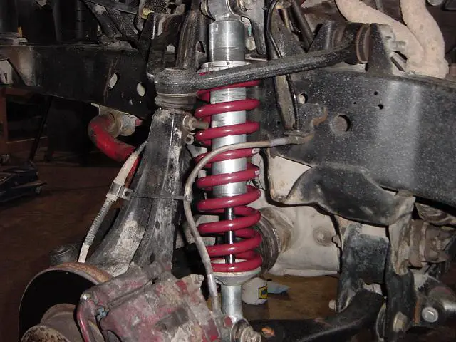

whats a coilover? and would a torsion lift still work even tho the torsion bars are welded instead of bolted?
The fab work is some grinding, possibly welding, and possibly swapping to 96+ torsion keys and pads.
A coilover .....
