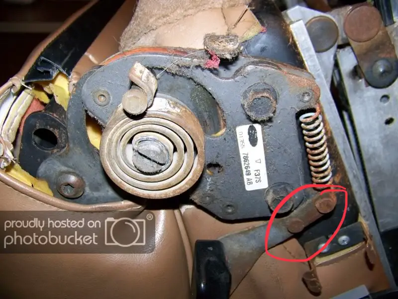

Bolts on- 2 bolts on the right, the torx bolt on the left, and one more under the seat upholstery, you can push the upholstery up far enough to get to it though:

Do I understand Joe Dirt's post correctly that it's riveted on so the easier route is replacing the whole mechanism?
When this happened to mine I drilled out the posts that held the original handle, tapped them and cut a piece of 1/2x1/2” angle iron and bolted it in. Tucks our of the way and has been rock solid for years. I shaped the angle into a handle shape so it doesn’t look janky.
How thick was the angle iron you used? Was that thick enough to not bend again or did you make it shorter to lessen the chance of bending?
What exactly did you tap, the plate that the lever is riveted on to or the lever itself or both? Is there not space behind it to use a lock nut instead or some other issue I don't realize? Is it that the bolt head needs to sit away from the lever enough to have clearance for the spring to hook on?
I might end up pulling one at a junkyard then take my time putting an improved lever on, subject to when I happen upon the materials though I think I have some 3/16" angle or 1/4" plate aluminum *somewhere*.
