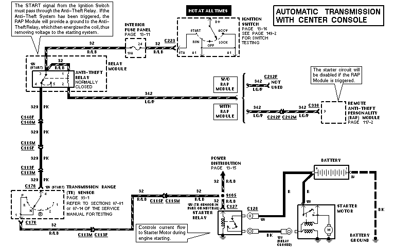

This diagram may be helpful. Check the starter relay that is located on the fender.

My last starter that went did so without any warning. One minute it was fine, the next there was nothing. If the terminals are clean on the battery and starter and the relays are fine you need to pull the starter and have it checked...
You can "jump" the starter with it on but if you don't know what terminals to cross you shouldn't do it....
Make sure it's in Park and also try starting in neutral.
