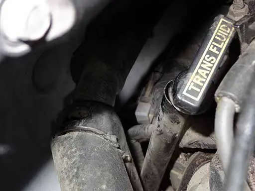

I found the SPOUT/Octane shorting plug which is undone to test base timing. This is for a 1996 Ranger STX 4.0 4x4. It's behind the Auto Trans dipstick and taped to the loom there. Gray plug. Cheers
