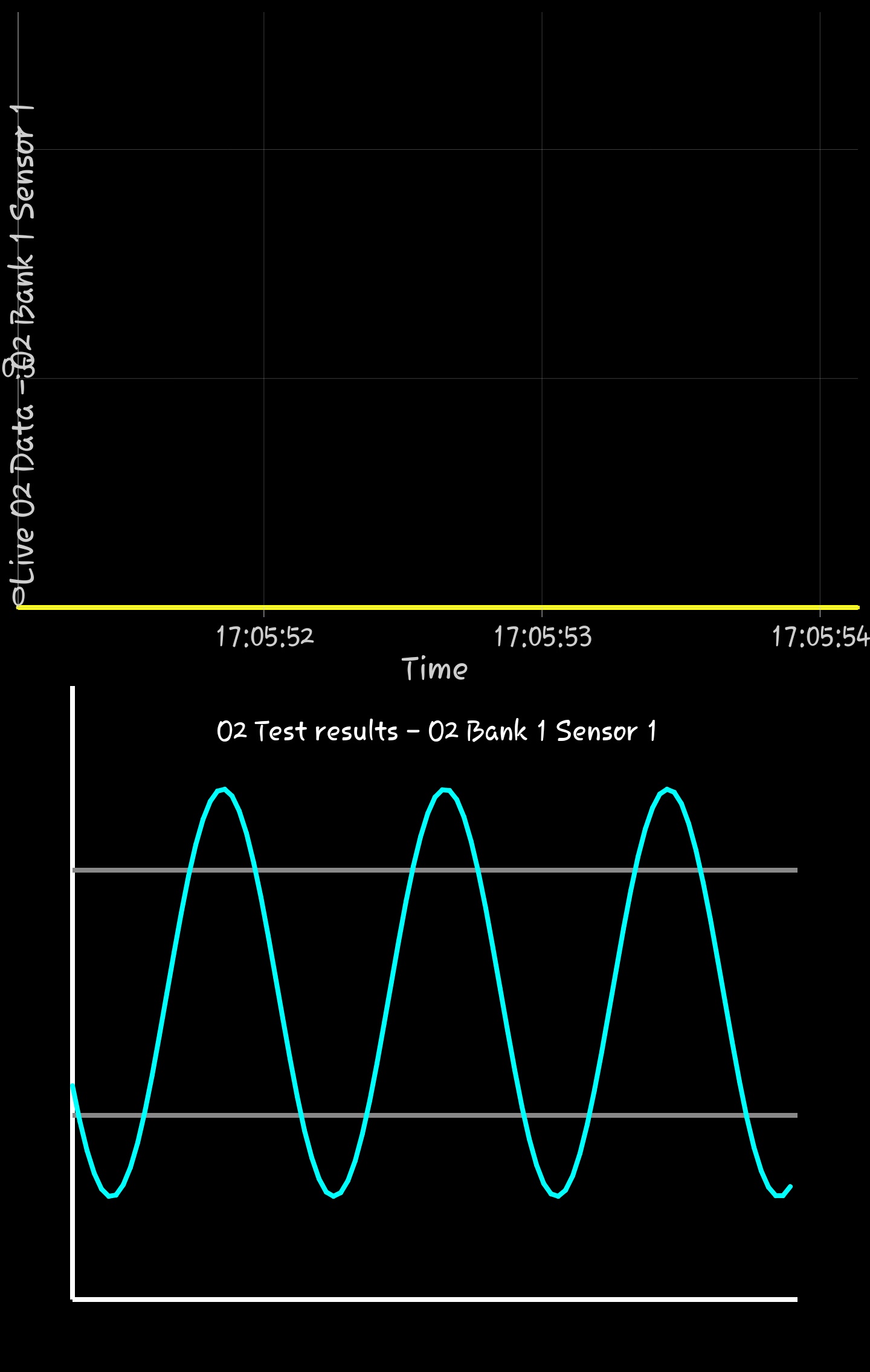

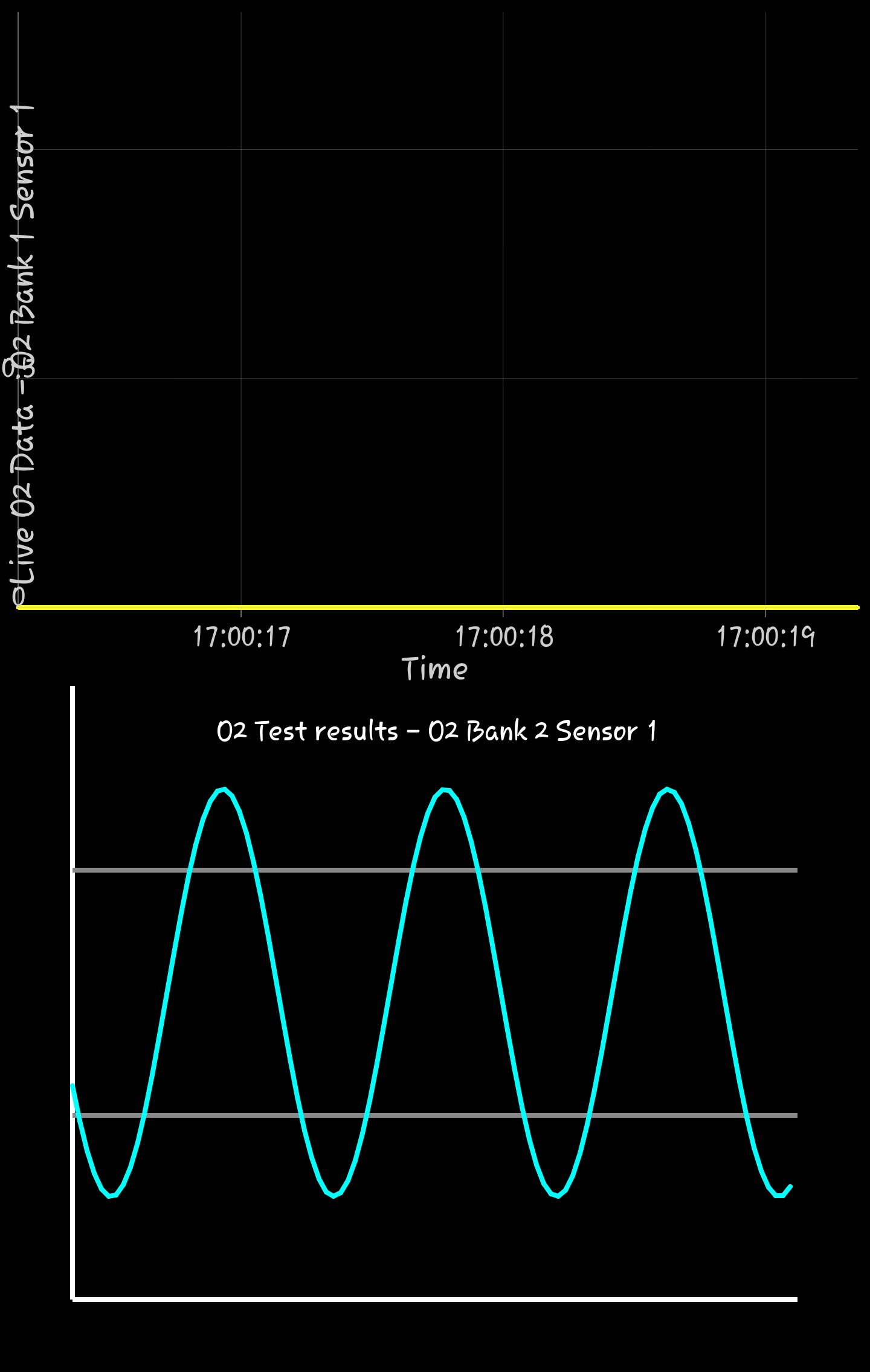

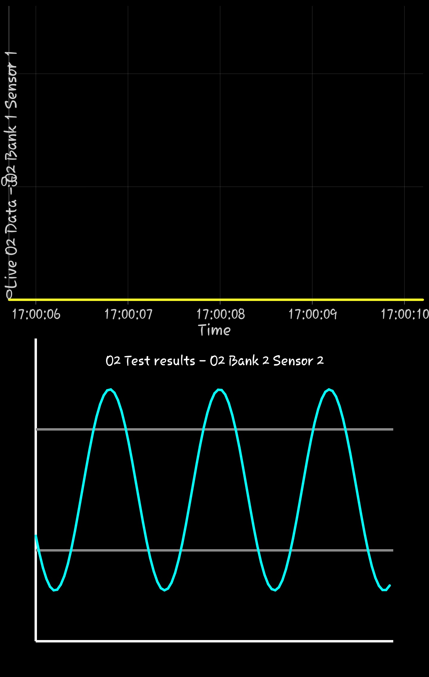

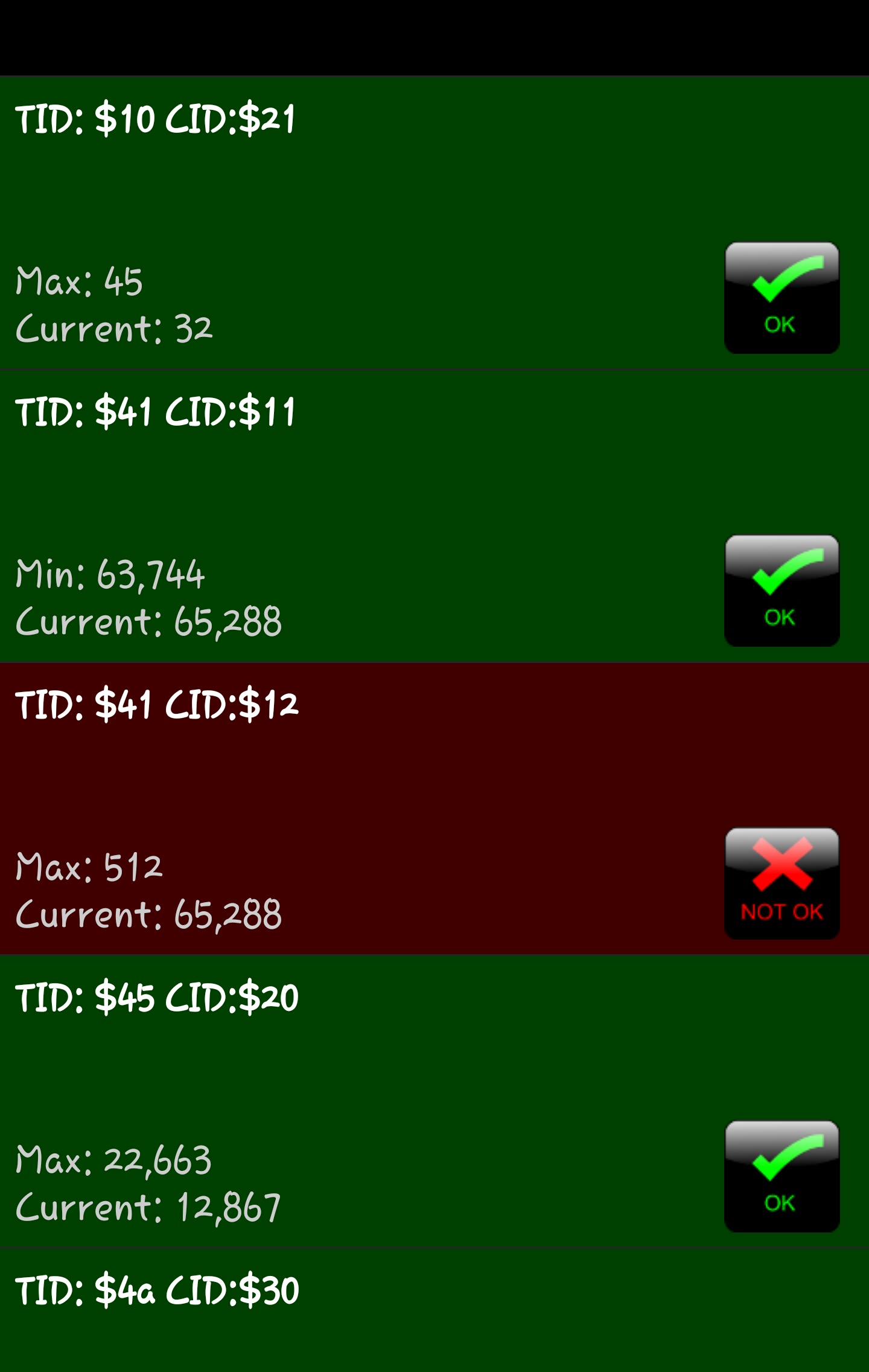

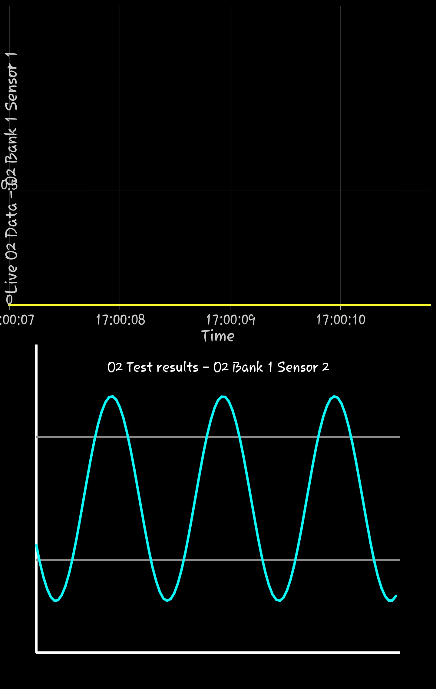

Here are the 02 screens shots
After checking fuel pump,pressure regulator and leak down. All are within specs. I now have this...
