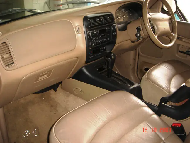

Oh and when you're used to looking at LHD Explorers, that picture is kinda freaky. ;)
