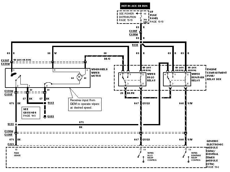

You need to see if the GEM is grounding the Tan/Red wire when you push the washer on the MFS.
attachment.php
ok, so i can disconnect the relay? or? where do i put the leads of the multi-tester, and what setting?
Yes, you can remove the relay from the box. Then find the terminal that has the Tan wire with Red stripe (T/R). Set the tester to read ohms (resistance). Put one probe on the terminal, put the other on a ground in the engine compartment. When you (or a helper) push the washer button on the MFS, the reading on the tester should go to zero (or near zero) ohms. The GEM is supposed to ground the T/R wire.
If the washer circuit is working, when you push the button, it tells the GEM to ground the relay which then closes the contacts on the relay to send power to the washer pump motor.

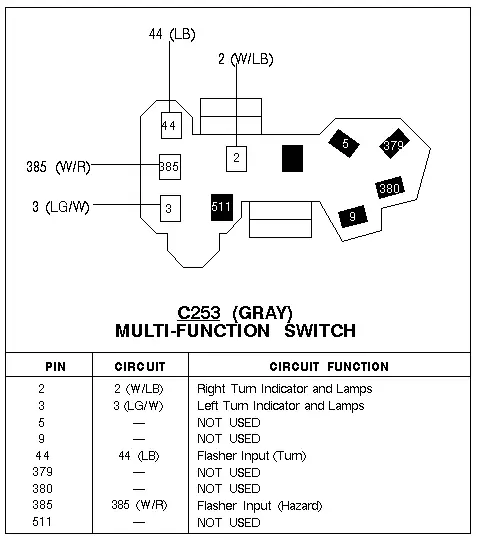

do you happen to have a picture of the layout of the fuse box, and which on it is in? i cant seem to find my owner's manual that lists that stuff, i have downloaded a fsm, but can't open it yet as i dont have the software
My manual is 97, but it should be the same.
